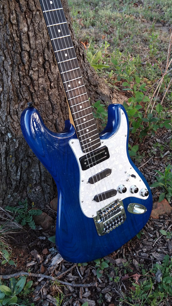

It's Finished! The mini switch, switches between the passive pickup (TV Jones Supertron, like in the '59 Country Gentleman, only in a soapbar cover) and the active "Peaver" EMG circuit.
With the mini switch in the up position, you get the TV Jones pickup. The upper knob controls the volume, the middle knob dials one of the coils out to make it a single coil pickup and the bottom knob controls the tone.
With the mini switch in the down position, the "Peaver" circuit is engaged and the top knob controls the volume, the middle knob is the tone control for the middle pickup and the bottom knob is the tone control for the bridge pickup. The lever switch is a three way switch that selects just the middle pickup, both the middle and bridge pickup, and then just the bridge pickup.
Here's some photos, it's hard to take them without getting a glare:
