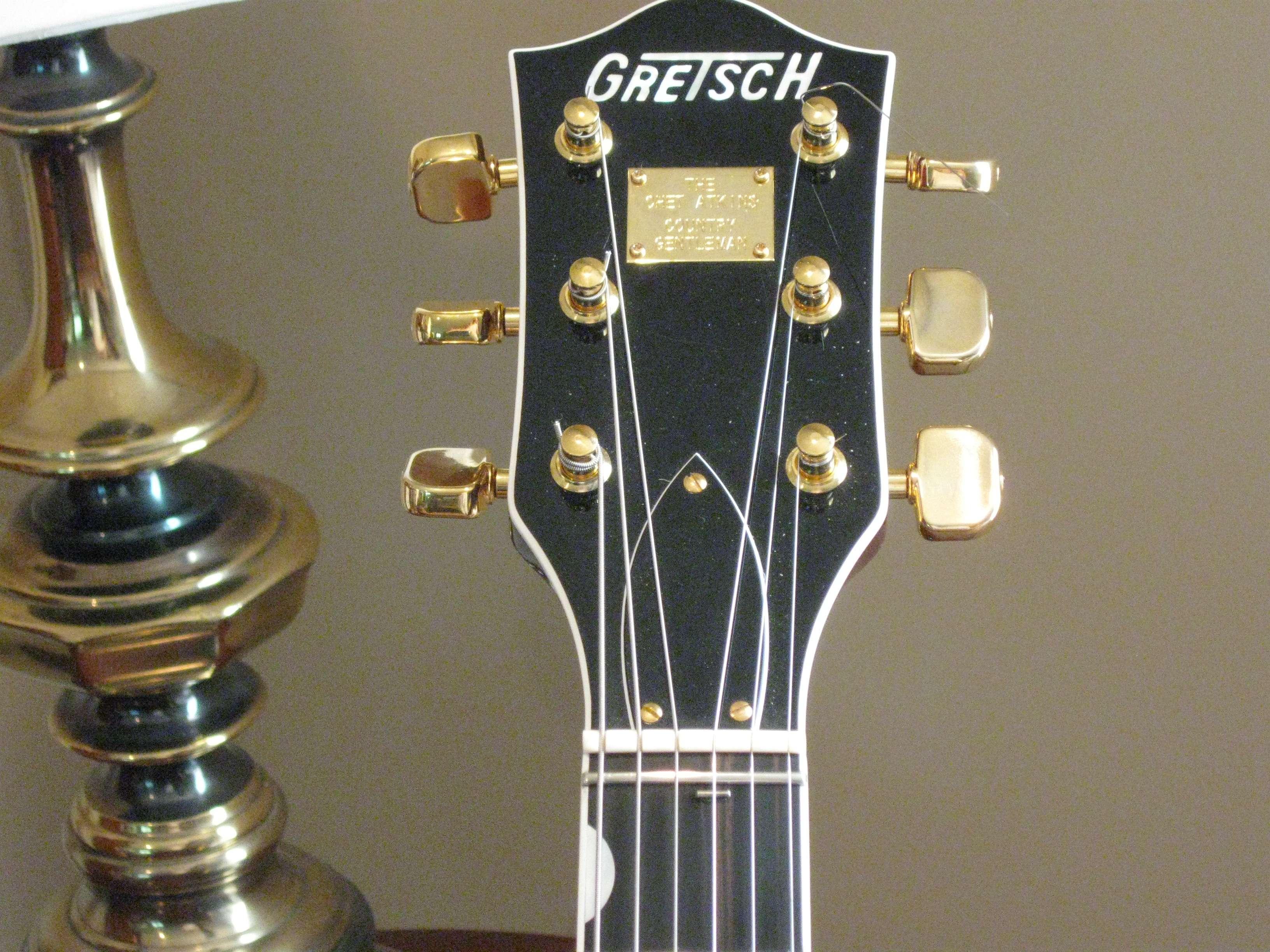

Chuck, I've never measured, but it feels about like all the other NC/CG's I've played. They're jumbo frets, pretty high. I just left them stock, except Sonny Thomas fixed a high fret for me. They're taller than standard Gretsch frets. The CGP has big frets, too.
I've also got a short length of piano wire that Paul gave me under the 3rd string, just in front of the zero fret. It's just glued down with super glue. It allows you to tune a plain .016 G string perfectly with the bar bridge. Chet's CG had some sort of mini-fret, like a banjo 5th string, under the 3rd string, for the same reason. It looks like a white dot in the photos.
http://www.craigdobbins.com/mini-fret.JPG
I'm thinking of "committing" and having a tiny "mini-fret" installed there. Of course, just as soon as I did that, I'd want to use a wound 3rd for something. I reckon what I really need is 2 CG's, one set up for a plain 3rd, and the other for a wound 3rd... ;)

Forgot to mention, I had the zero fret taken down to the same size/height as the other frets. A lot of times, the zero fret on a new Gretsch is just a little too high for me. I like the action at the open position as low as if you were using a capo, but a higher action at the bridge.

Thanks for the info Craig. That mini fret is interesting.
