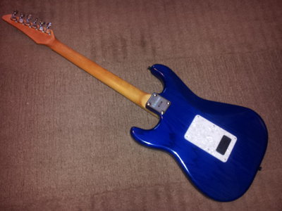

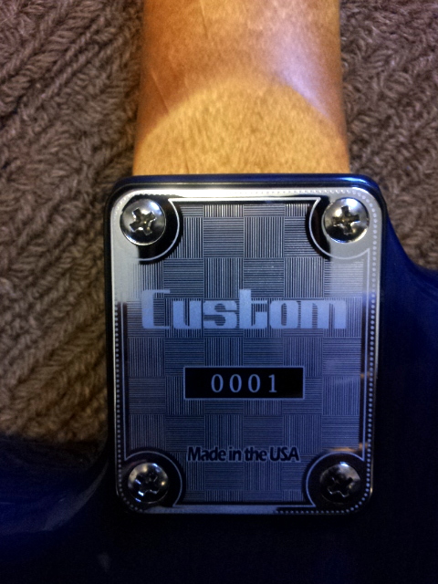

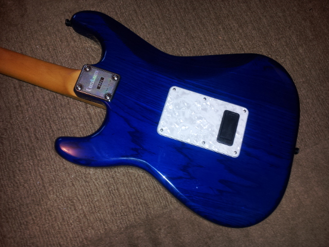

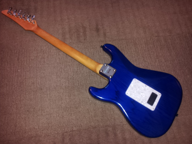

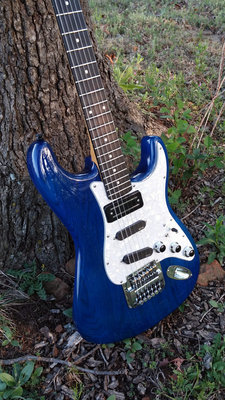

Ok, some progress has been made! First off the battery box didn't fit in the tremolo cavity without drilling some of the wood out. I used one of the flip out battery boxes for the Peaver EMG pickup circuit, so the battery can easily be changed. As you can see the back side of the guitar is finished complete with a custom neck plate! Here's some photos of the back, excuse the glare that looks like spots in the finish:
I've also started some work on the front side. The Kahler hardtail bridge did not cover the tremolo hole like I thought it would. Thankfully they make a adapter plate that does, although you do have to modify it to make it work. The TV Jones Supertron (Chet Atkins '59 CG neck pickup) comes with 4 conductor wiring, so I'm going to use one of the stacked pots to dial one of the coils out from humbucking all the way down to a single coil. This will add even more versatility to the guitar.

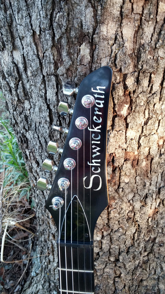

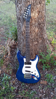

It's Finished! The mini switch, switches between the passive pickup (TV Jones Supertron, like in the '59 Country Gentleman, only in a soapbar cover) and the active "Peaver" EMG circuit.
With the mini switch in the up position, you get the TV Jones pickup. The upper knob controls the volume, the middle knob dials one of the coils out to make it a single coil pickup and the bottom knob controls the tone.
With the mini switch in the down position, the "Peaver" circuit is engaged and the top knob controls the volume, the middle knob is the tone control for the middle pickup and the bottom knob is the tone control for the bridge pickup. The lever switch is a three way switch that selects just the middle pickup, both the middle and bridge pickup, and then just the bridge pickup.
Here's some photos, it's hard to take them without getting a glare:
