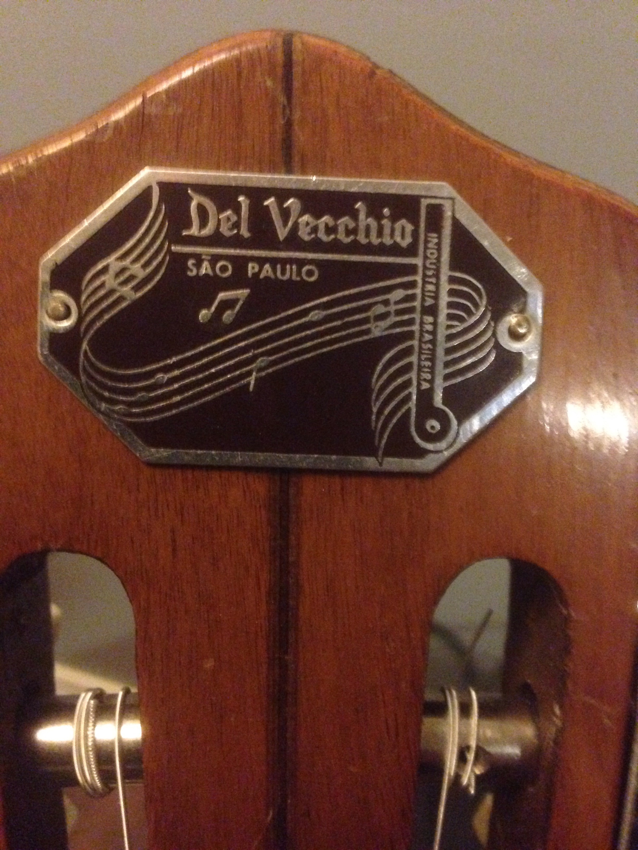

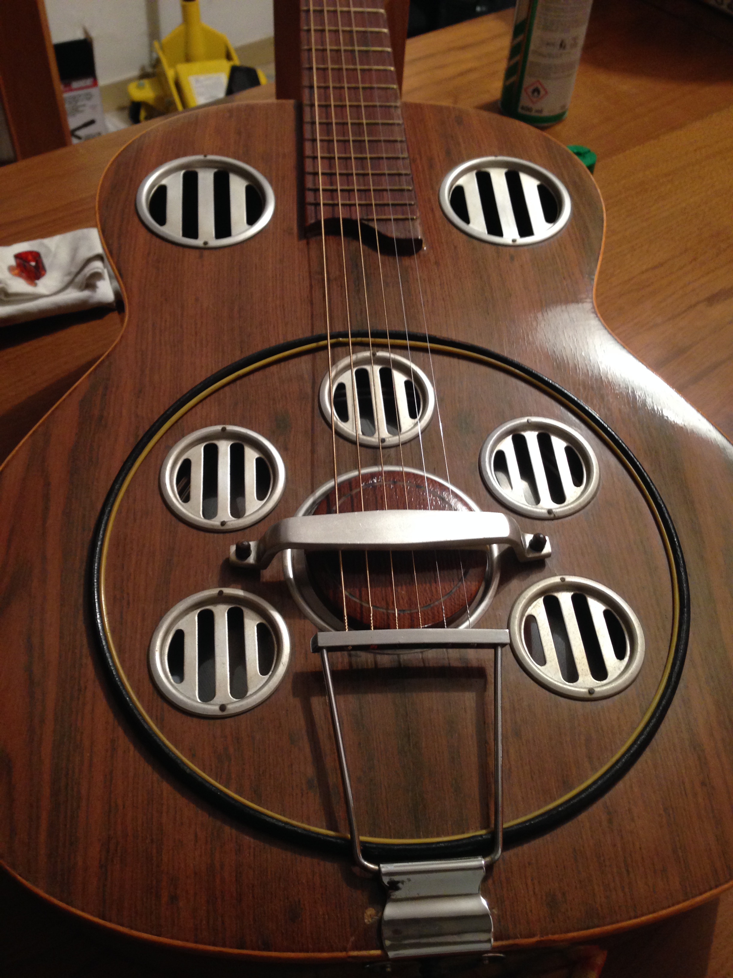

Postby Douglas » Tue Jun 07, 2016 7:52 pm

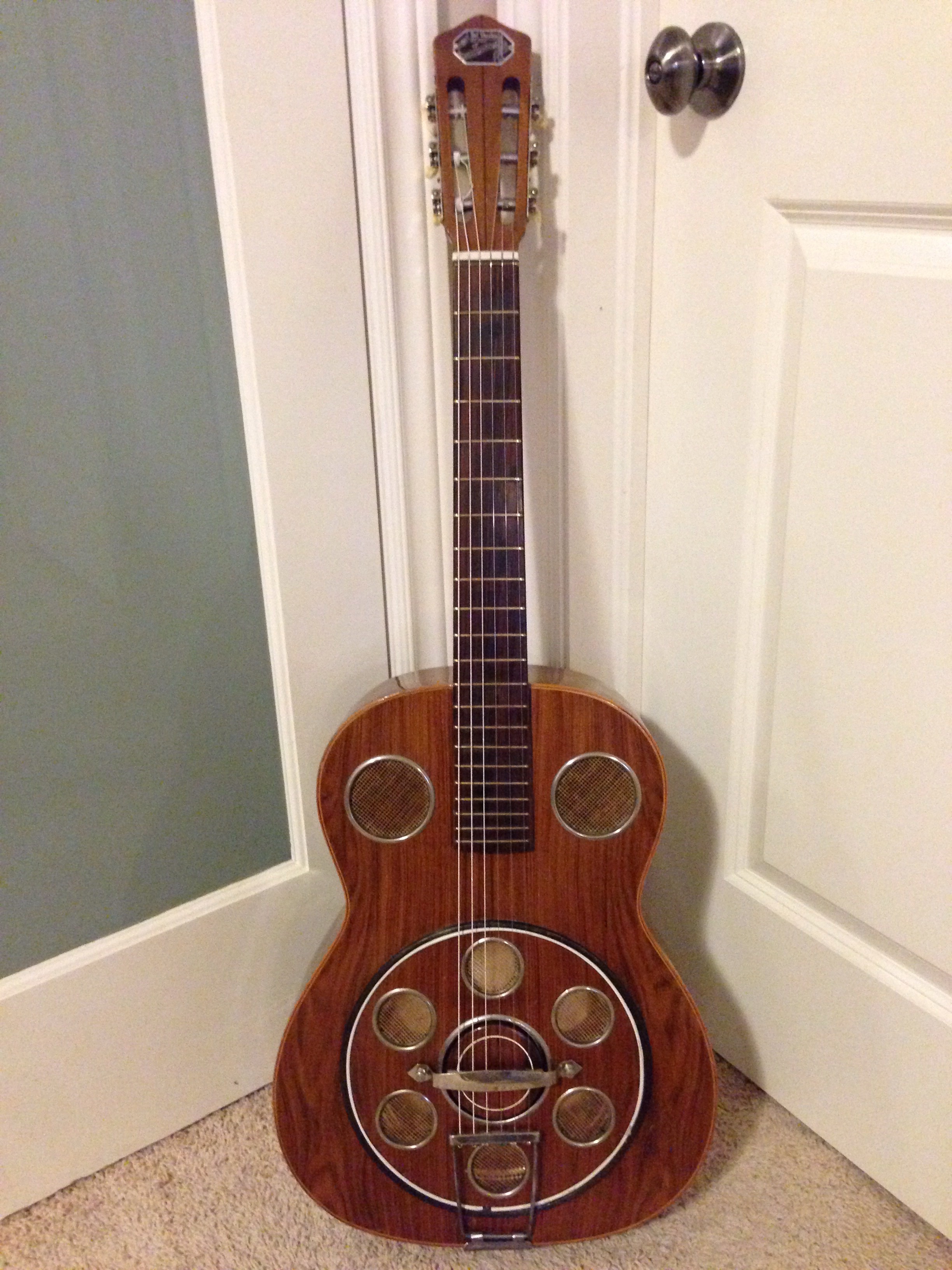

Finally was able to find a Del Vecchio that was playable. It looks to be an older one with Dancing Note logo on the headstock. Somewhere along the way over 55+ years, the resonator cone was replaced with a non DV unit which required attaching the biscuit via screws. It sounded OK, but a bit dead. I was able to get a replacement Paul Beard Delvecchio cone and it now sounds a whole lot better.
I've tried recording the DV, using an AKG C2000B condenser mic into GarageBand. It took a while to find the best spots for mic placement, but generally towards the bridge end of the guitar sounded best. In general, the player doesn't get to enjoy the sound as much because you're effectively sitting behind the soundbox. Mic'ing it with headphones or an amp OR playing in front of a hard wall sounds good too.

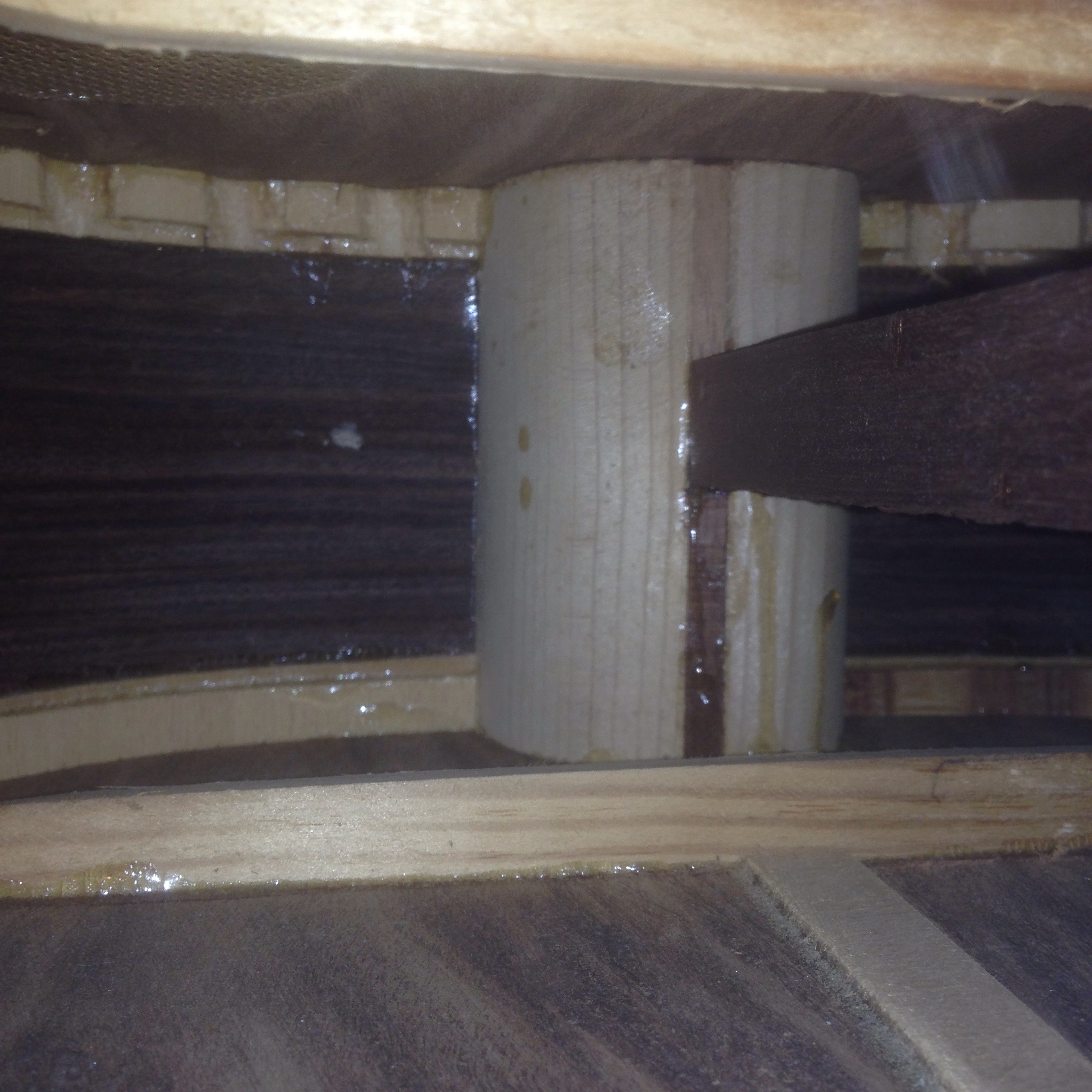

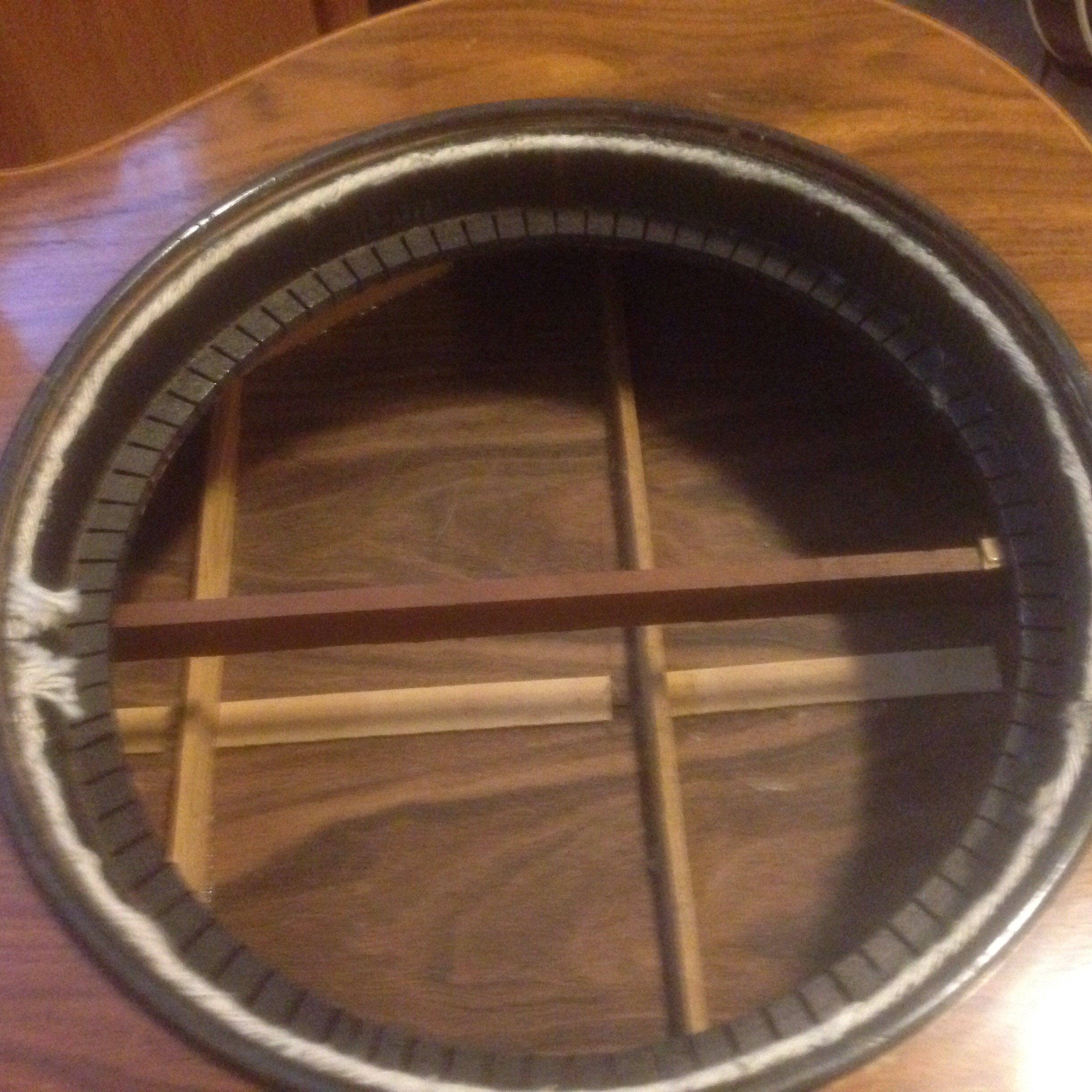

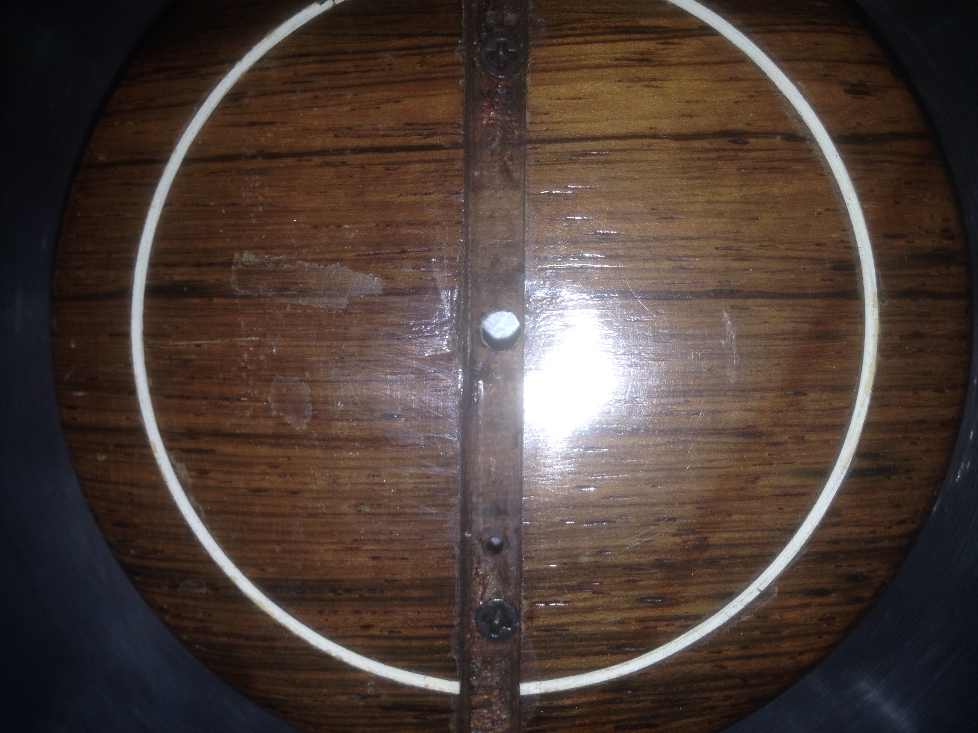

Here's some images of the inner workings of the Delvecchio taken during the cone replacement:
1. The biscuit with screws!!!
2. Wooden sound well: note the hi-tech string!
3: A peek inside looking forward to the neck:

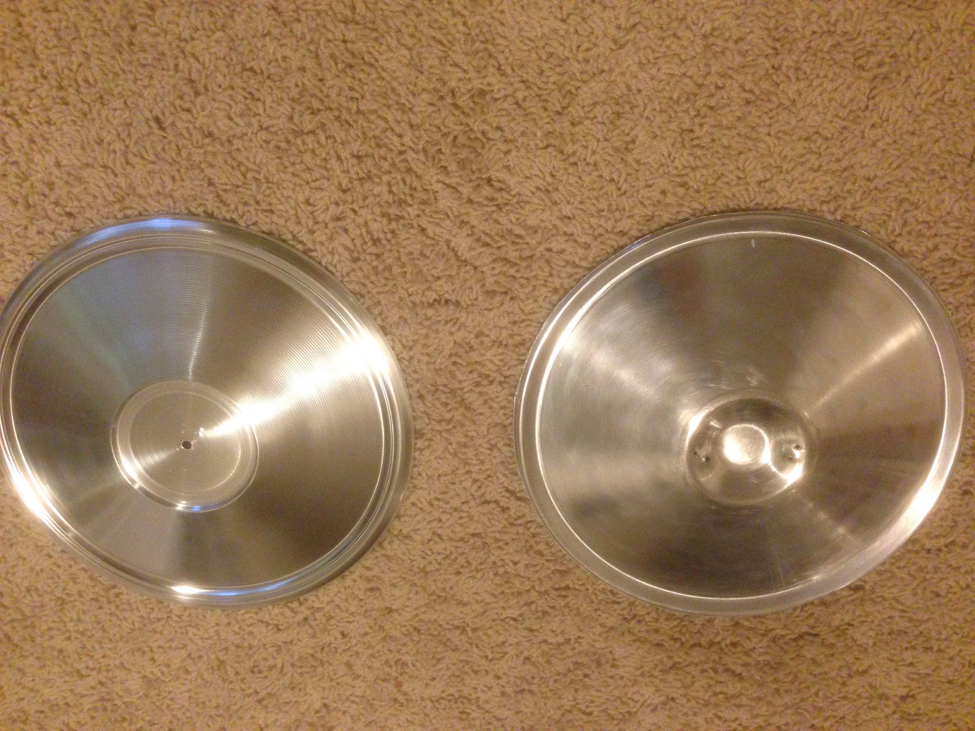

Postby Douglas » Wed Jun 08, 2016 6:15 pm
And lastly, the new vs old cone. (note the screw holes and difference at the top of cone):

Postby Norm » Wed Jun 08, 2016 6:41 pm
I'd be willing to bet the resonator on the right was not original to the guitar because the puck that is the bridge base on those things is more like the one on the left over 2" wide if I remember correctly
It's like the previous owner got a resonator either from Del Vecchio intended for a different model or something. In any case, the one on the right looks wrong in too many ways

Postby Douglas » Thu Jun 09, 2016 1:20 am
Norm wrote:I'd be willing to bet the resonator on the right was not original to the guitar because the puck that is the bridge base on those things is more like the one on the left over 2" wide if I remember correctly
Note to Steve Sanders
Beard has the things. You just need to root around in their website a little deeper
http://www.resophonicoutfitters.com/category/016.html
Norm,
My thoughts exactly on the cone. The original probably got collapsed and the owner got something that "sort of worked". The biggest problem I had with the new cone in the bridge ended up being to low, since the previous owner shaved it to compensate for the taller apex on the nonDV cone. Had to shim up the bridge about 3/16ths. The action is good on this DV, on par with a Taylor or Martin.
I got the Beard replacement cone from Elderly since I've had good experience in the past with. Took only 3 days to get to Canada.
Found the best balanced tone string wise was to follow the recommendations elsewhere on this forum. Ended up going with the D,B, & high E from the Martin silk and steel set (lights), a plain .017 steel for the G, and Martin Classical nylon ball end for the low A and E.
Doug
