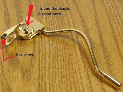

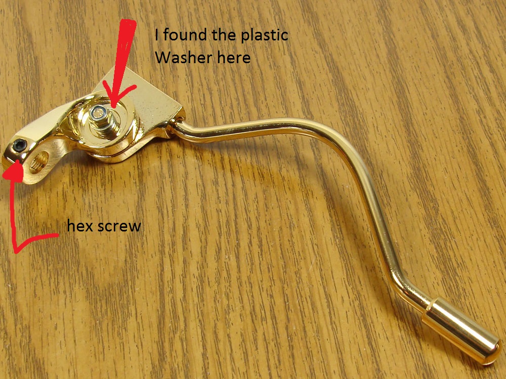

I just loosened the strings, flipped my swivel bracket, loosen the hex screw located under and extracted this;
after I entered the stationary bracket and screwed the hex screw (just enough, not too much).
My doubt is this:

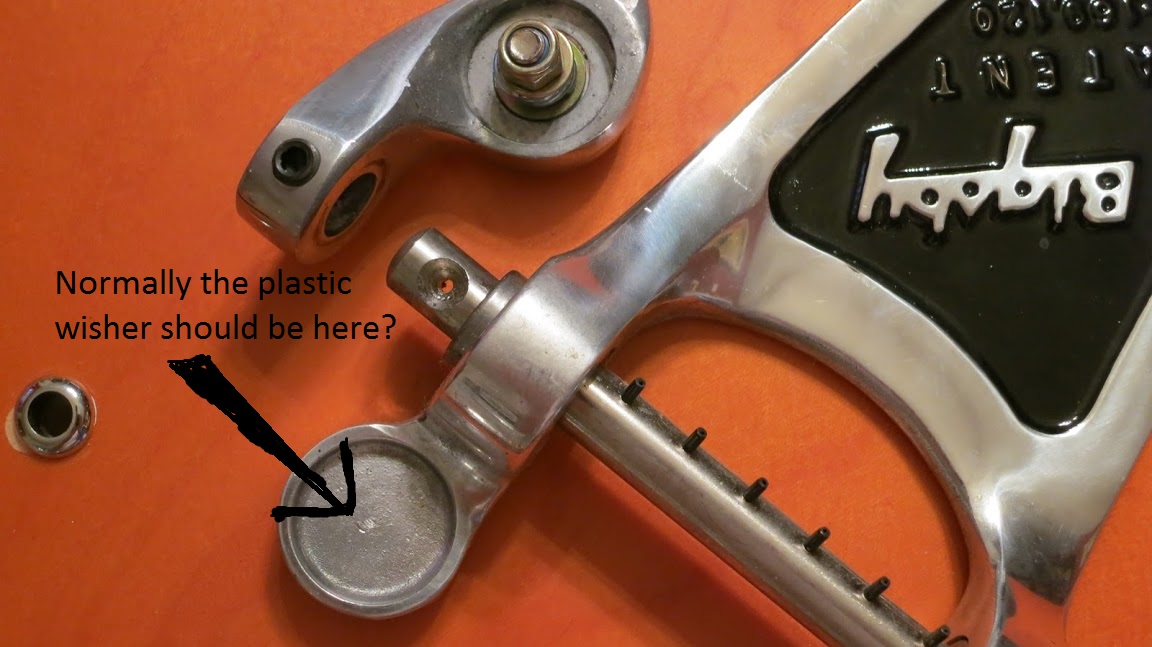

I found the PLASTIC WASHER between the spring and the swivel bracket !!!!!!!!!!
But normally this goes between the spring and the bottom of the support base of the spring?

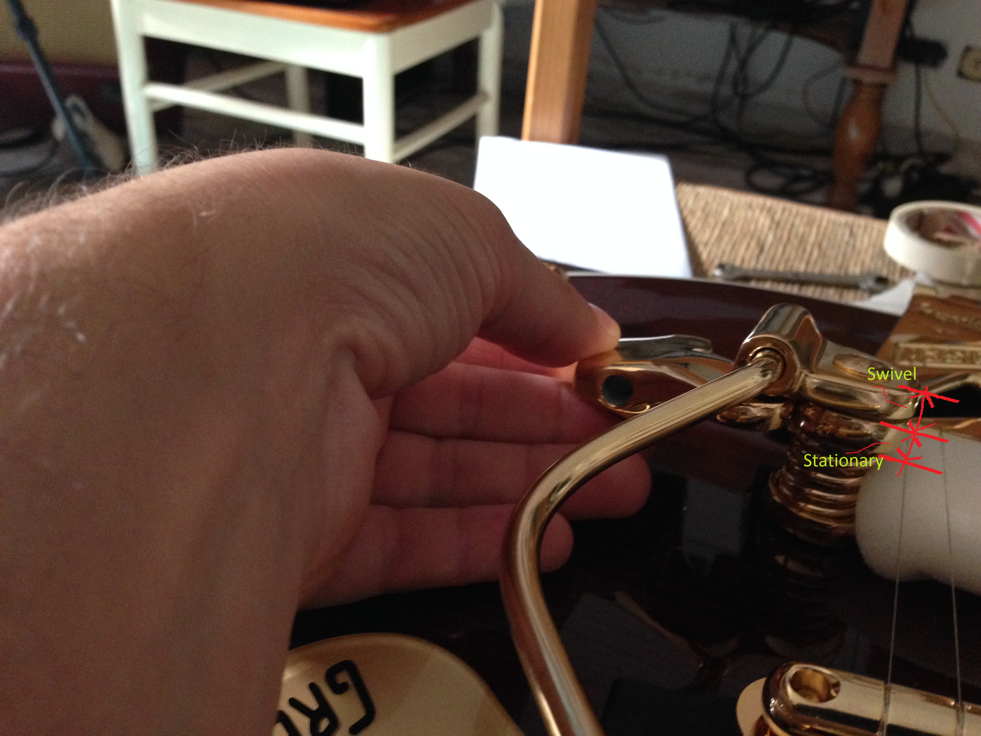

I also noticed that the stationary bracket is a little harder than the swivel, is this normal?
I will test this stationary bracket for some time, however, the first impressions were good.
Thank you, I hope I was clear in explaining my problem.
PAOLO SPADARO

Put the plastic washer in the cup. If the assembly seems to tilt the handle tip too high, take it out.
I think it was there partially to make sure there was no metal on metal noise as the swivel was moved.

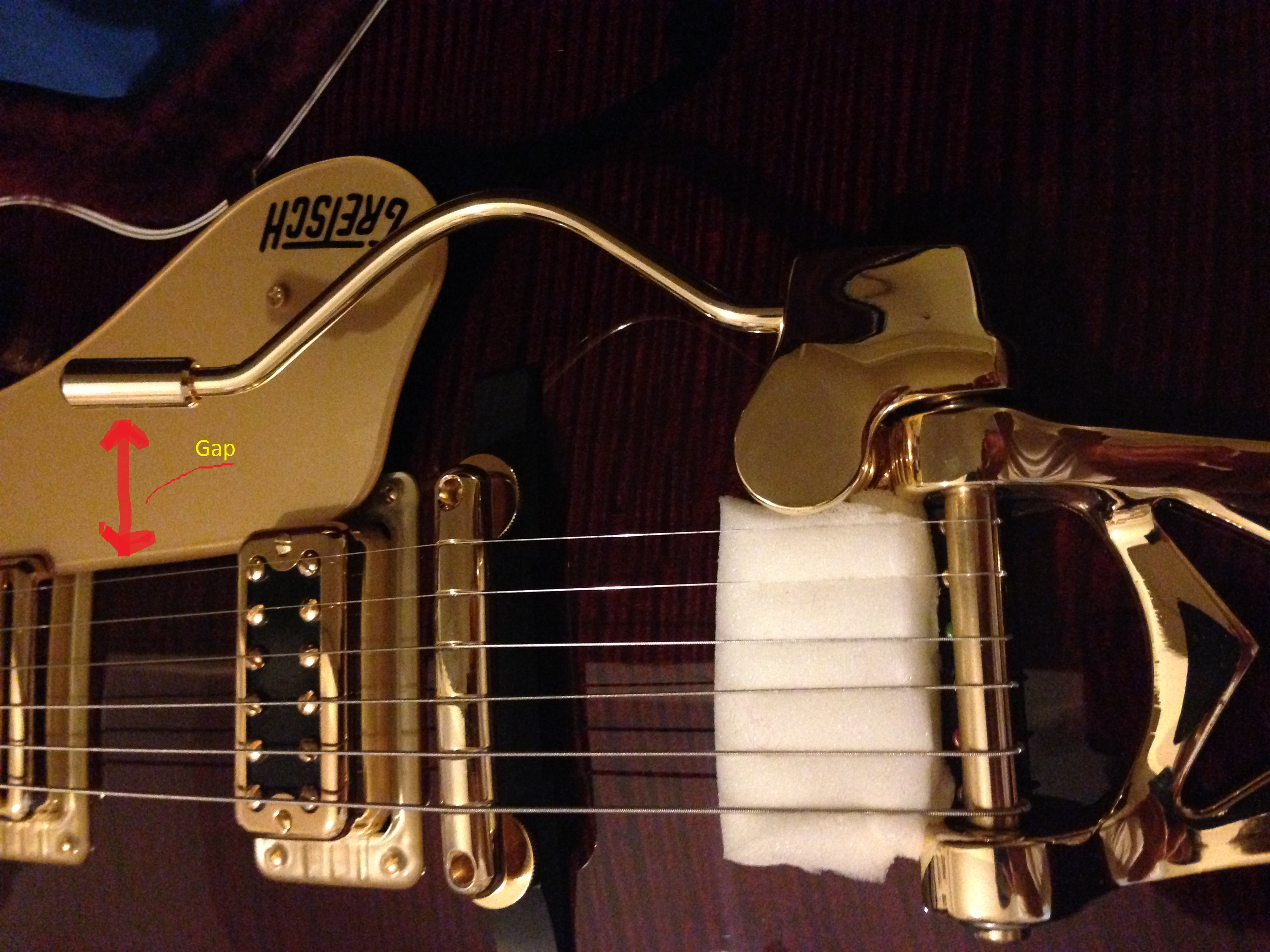

You may want to bend the rod a bit to suit yourself. If you bend at the tip be sure to unscrew the tip first to lessen the possibility of breakage.
It takes a little time to get used to the stationary bracket but once you get it properly placed, if you really like using your Bigsby, you'll never look back.
As for 'proper setting'...I think the ideal is to have the tip just about where your middle finger curls when your right hand is in "Chet position"

I made the switch a few months ago also, Paolo. The stationary bracket is a little stiffer, it seems. I am still not completely comfortable with it, but it's getting better. I am a little unclear on the plastic washer. I always figured that was to keep the spring from wearing into the Bigsby itself. Smooth operation, noise free, is the goal.

Just wanted to chime in and let you know that I have my plastic washer between the spring and the handle side of the bracket (not the guitar side). Not sure where I heard to do this - but that's how I have mine setup. It makes sense because that is really the moving part which contacts the spring - so you would like to remove as much friction as possible. You should research on Paul Yandell's questions and answer pages about "pinning" the bigsby. May be something to consider if the geometry is correct for your bigsby. I actually pinned mine on my 6122-1959, but because of how things lined up when I screwed the base bracket to the guitar, it actually put the other side of the bigsby in the air! I didn't think that was a good idea, so I removed it. But I definitely do like the idea of having it fixed to the guitar. I had a similar setup with a Gibson CG I had and it worked much better than my Gretsch. Just some thoughts for you to consider. Take care!

So collecting your tips I've come to consider leaving the swivel bracket on the guitar, a little tightening the screw that allows the rotation so that it becomes a little more steady. Thus leaving everything in the original configuration included plastic washer. (Norm, I do not have the courage to bend the lever so as to eliminate the gap and it is very similar to Chet, I think it's still a fair idea :) :idea: )
Richard also think I understand (maybe) why the stationary bracket is a little harder, because the angle of attack of the lever is on a lower plane than the plane of the swivel bracket.
