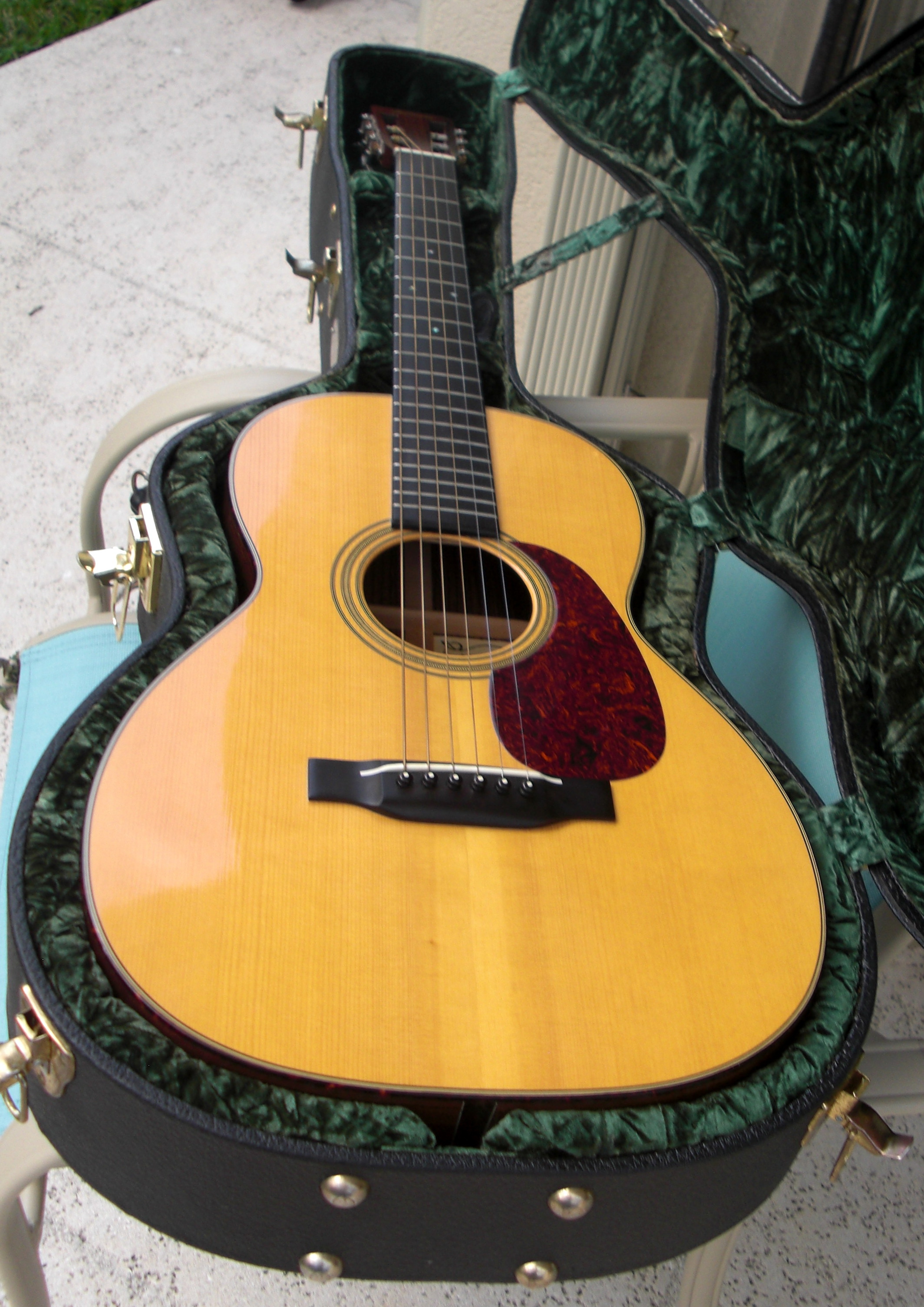

I have a new - old guitar I'm playing. It's a '98 Martin 00-21 Golden Era limited edition #146 of 164. Small body, rosewood with Adirondack top, short 24.9" scale, 1-7/8" neck, 12 fret, slot head stock, and it works great to transition from nylon string 2" neck. I tried it unplugged yesterday at the Smoky Mountain Visitor's Center and it was plenty loud for the small venue. Easy to play all the way to the 12th fret using full chords, even when playing Chet's "Girl Friend of the Whirling Dervish".
I'm looking for a good natural pickup system other than under-saddle transducer since this has a 'through-saddle' bridge. I'm torn between an LR Baggs Lyric (Tru-mic) and K&K both of which mount on the bridge plate under the top. I'm using Martin custom light (.11-.54) phosphor strings.

I appreciate the suggestion, but I can't use an under saddle or saddle replacement like the Barbera Soloist because the guitar has a 'saddle-through' bridge and the saddle is glued in. It takes a delicate technique to remove and replace the saddle and I don't want to risk affecting the integrity of the guitar. I am using a Barbera in my Buscarino Cabaret which really works good and doesn't require a preamp. Thanks!
