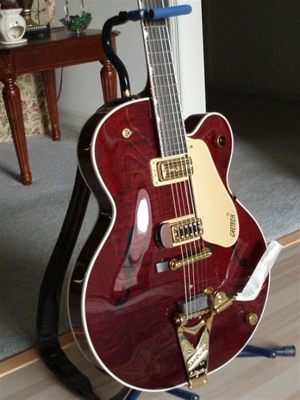

I have a question for y'all.
I was looking at the guitar gallery on Paul Yandell's site and noticed on his Gretsch 6122's and his 6120 he has a block of foam wedged under the strings just forward of the Bigsby. Is this for buzz dampening or something? I've seen other guys doing this as well and have found no answer.
Also, there is a small "tab" on top of the bridge pickup on a couple of his guitars. Some type of palm rest maybe?
Oh, and the screw clamps or whatever that are attached to the strings between the bridge pickup and the Bigsby? I have no clue.
OK...3 questions. 8-)
Paul was such an innovator on electric guitars. I would love to try one of his "half super-half filter tron" pickups as I call it. Great idea!

Greg, I believe the block of foam is to dampen sympathetic vibration from the strings between the bridge and the Bigsby. I don't know what the tab on the pickup is, but I'd guess it's some sort of palm rest--there are others who probably know for sure and will chime in. The "clamps" between the bridge and Bigsby look to be fine tuners--like on violin, although the photo you posted isn't quite clear enough to make them out for sure. If you look in Me and My Guitars, you can see that Chet had put fine tuners on a number of his guitars.

I thought I would add Chet's answer about the block of foam. I wrote Chet a letter asking him about it after the CAAS convention in 1995. He sent me back a handwritten note that said:
Chuck, it is to stabilize the strings and to keep them from vibrating sympathetically. It's just a piece of foam rubber.
Chet

I went out to Menards and bought some 1 inch Black foam pipe wrap insulation. You get about 4 pieces per bag. It's cheap. I then cut One piece about 3 inches off of it and then I cut that 3 inch piece down the middle and stuck it after the bridge and in front of the Bigbsy. Looks nice and blocks out any unwanted vibration. Check it out. The best part is it looks excellent and does the job. Hope that helps you out. Joeb
