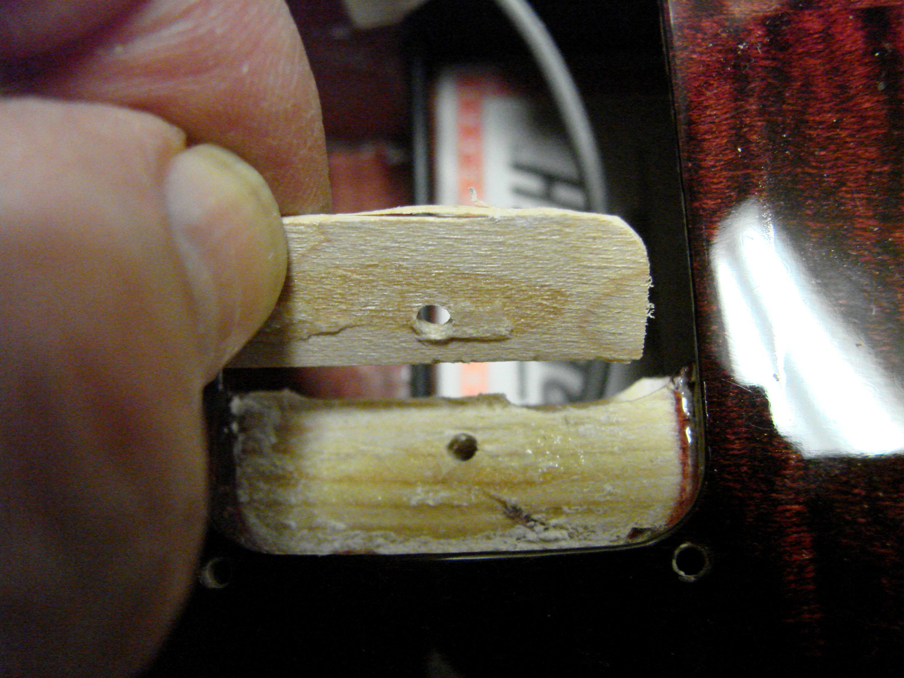

Postby smokymtguitar09 » Tue Mar 19, 2013 7:57 am
I have been able to tilt the Supertron neck pickup in my 6122-59 Gretsch CG in order to better balance the bass to treble string sound. Paul Yandell had suggested this technique. I removed a shim on the bass string side and left the treble side shim in place.
Interesting that when I removed the pickup the Gretsch model & SN label could be seen attached to the inside back of the guitar. I also noticed that the pickup mount was attached to the top and back much like a sound post (not sure if that was it's purpose). The pickguard neck screw has to be removed and the pickguard rotated for access to the bezel screws. The two long pickup wood screws have to be removed to completely in order to remove the pickup. The shim is lightly glued in place and to remove it I used an Xacto knife to loosen then pluck it out. The shim is very thin which, when removed, drops the bass side of the PU enough to allow the treble side to be a bit more dominate. See the photos for an illustration of the process. Be careful to not over-tighten the bezel screws otherwise it might crack as I have seen on some '60s CG's.
Removing shim
http://s205.photobucket.com/user/Slowpi ... %206122-59
