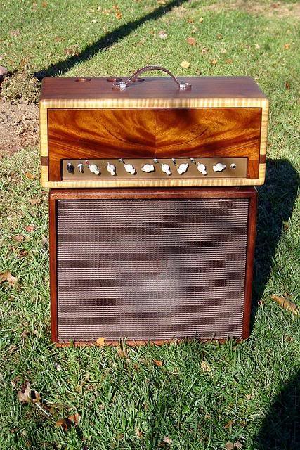

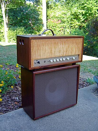

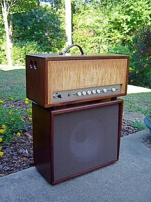

See below for some samples of my friend's amps. These are just samples; I plan on having the same combo cabinet shape as the original 25L15. However, we will be using ribbon mahogany for the overall cabinet, the flashy crotch mahogany (as in the face of the second pictured amp) for the lower front trim panel, and flame maple accents.

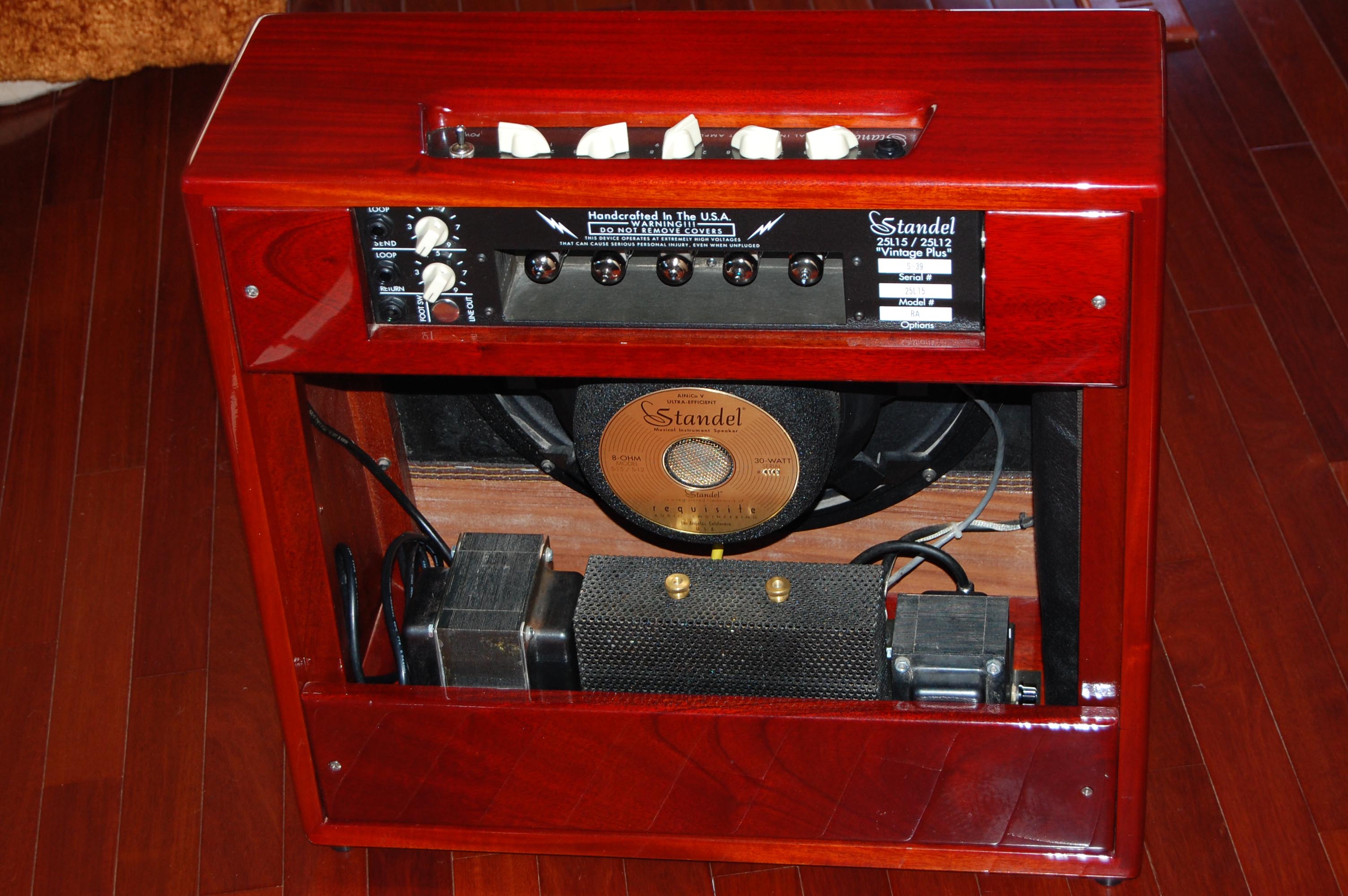

Great looking amps! This should be an interesting build. I like your idea of using hardwoods. It sure does add to the weight of the amp - but man it looks beautiful. This is the amp that I have. It's so beautiful. Just thought you would like to see it. If you would like any measurements - let me know. Thanks!

Now that's gorgeous! I love the color.

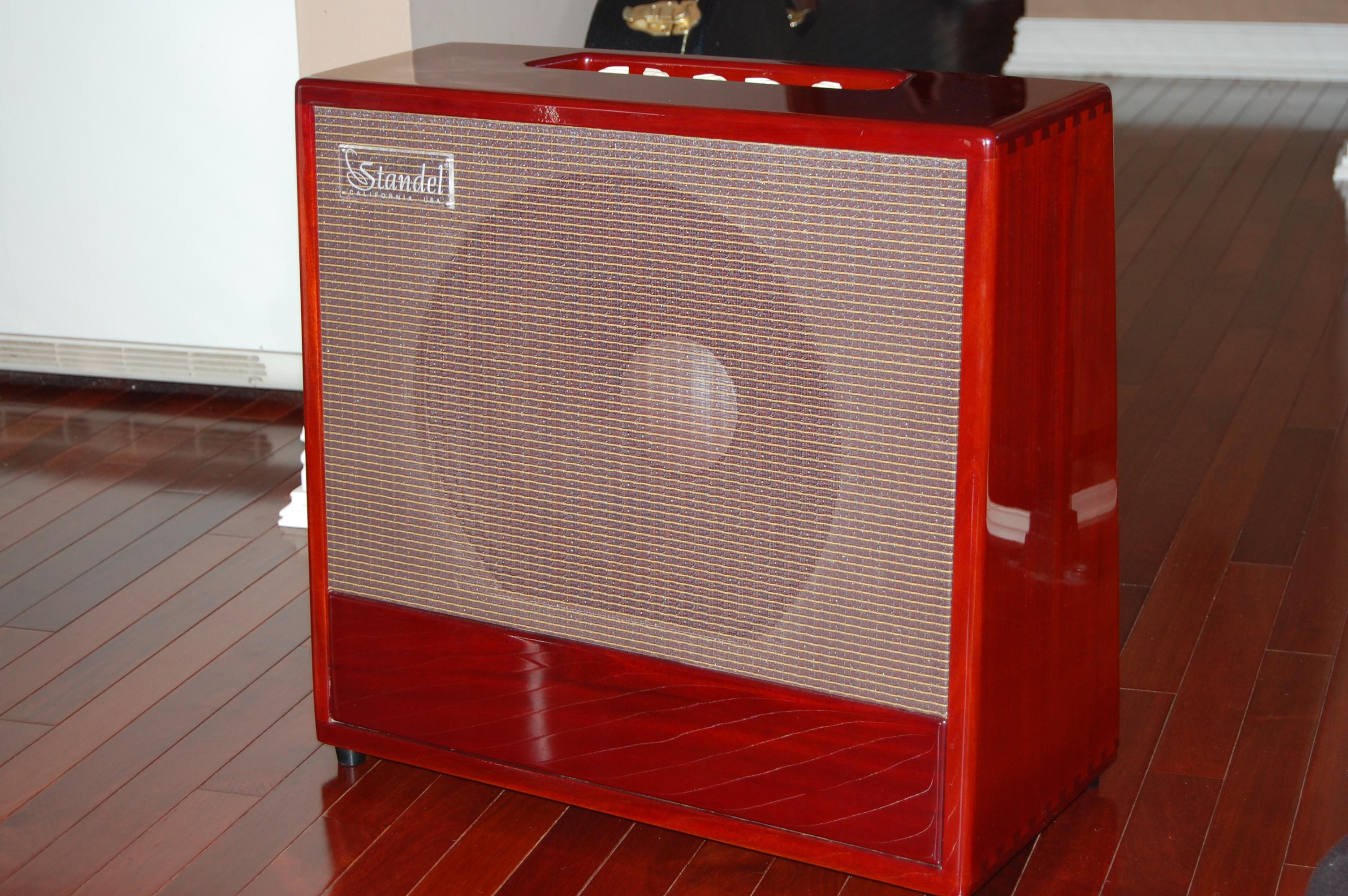

Here is the one I have...it is also an early reissue, with the contour control.
If I am playing Chet stuff, I usually have the midrange rolled off...which is supposedly the same circuit as the old ones. It does come in handy on other things, though.
