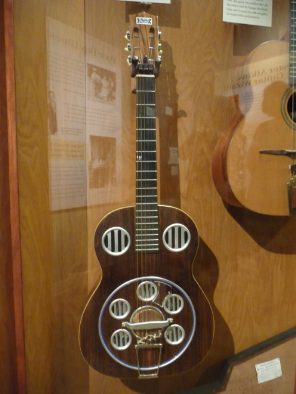

Postby guitarchuck » Mon May 20, 2013 6:18 pm
Here's a couple of photo's of the Del Vecchio that Doyle Dykes gave Chet. It has the metal cone well. You can see the metal cone well top ring in these photos:
You can click on the photos above and enlarge them to see the detail.
Dan provided me with the following info about the cone wells:
You can see the top/rim of the metal cone well showing around the cone well cover. The cone well cover actually sits inside this ring of wood or metal on the top of DVR cone wells. This metal or wood ring is probably glued to the top of the guitar, and the metal one is screwed in two places to the reinforcement brace that runs directly below the cone well from the neck to the tailpiece block. The wooden cone wells have a wooden ring, that is the top part of the wooden cone well, that shows up on the top of the guitar, instead of the metal ring. The wooden cone well rim is usually black painted wood with maybe a painted white ring on it, depending on the age of the guitar.
Also interesting is the plexi-glass finger rest on this guitar, and note the "cgp" that's inlaid on the neck. Chet seemed to really like this guitar. You see it on TV appearances in the later part of his career and we've been told that that he recorded a lot with it during that time. Long scale and metal cone well.

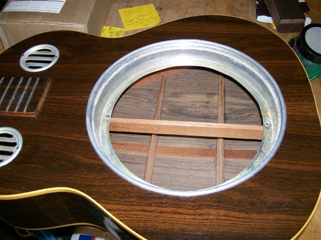

Re: Chet's Paul McGill resonator
Postby DAN SAGE » Mon May 20, 2013 10:44 pm
Thank you immensely for the two pictures. Here is a picture of the insides of my short scale/small cone DVR with a metal cone well, in case people don't want to tear their's apart to see what is inside. If the picture succeeds in posting, you can plainly see the reinforcement bar running directly below the cone well. The cone well is actually attached to it with a couple of screws. The bottom lip in the cone well is what the cone sits on. This photo was taken, while my luthier was working on it.
It is still a work in progress.
Dan Sage

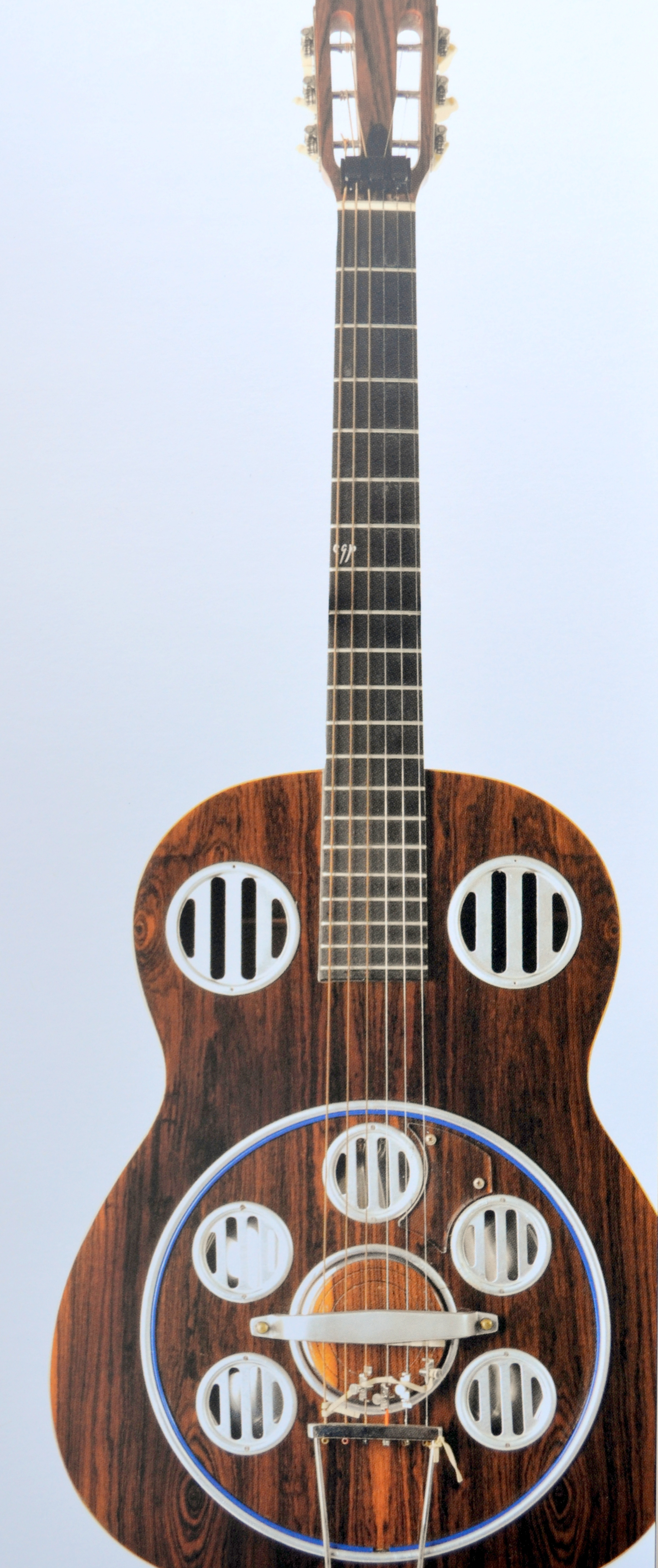

I made three reso's for Chet. The one here in koa was the first, I remember getting a letter from Chet at the request of the buyer, I probably wrote it and they re typed it on his stationary for him to sign.
The second Reso was brazilian rosewood with sap details. It had 14 frets and Chet asked me to replace it with a 12 fret model so he could find the octave like he was used to.
The last is Curly maple and is owned by his grand son Jonathan.
