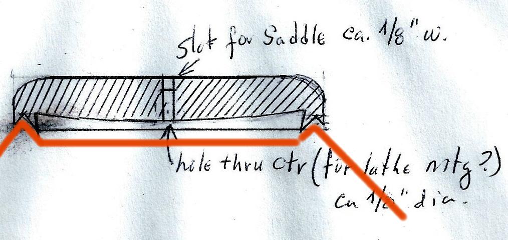

Dean: Here you are--
This is a quick sketch I drew up and when finished, I realized I had overlooked that there was a bit of land between the annular Vee groove in the underside of the "biscuit" (which engages the cone) and the hollowing out in the center. I also notice that the right hand side of my drawing goes off the edge of the computer screen. My note here reads "hole thru ctr. (for lathe mtg.?)". I hope this helps.
Bill

I thought the biscuit sat on the flat part in the center of the cone. Are you saying is sits in a groove on the biscuit on the rim of the center of the cone as below?

Postby bill raymond » Thu May 16, 2013 4:40 pm
Yes, Dean, that's correct. As I mentioned, my sketch omitted a small flat space between the Vee groove and the center hollowing, as were it made as shown there would be a great likelihood that the sharp ridge would break out where it was cut cross grain (the biscuit at the flat is about 2mm. thicker than at its periphery). I also omitted the narrow white plastic inlay ring on the top side of the biscuit--it's just a bit of decoration. I should note, too, that the grain of the wood biscuit runs parallel to that of the guitar top and the top of the biscuit isn't entirely flat, but is very slightly convex.

Postby guitarchuck » Thu May 16, 2013 4:52 pm
I could be wrong, but I don't think the ring on the bottom of my biscuit is v shaped. I'm pretty sure mine has a flat surface ring that makes contact with the flat area in the center of the cone. I'm curious about the biscuits that Dan measured. How are they made Dan?

Postby guitarchuck » Thu May 16, 2013 7:00 pm
guitarchuck wrote:I could be wrong, but I don't think the ring on the bottom of my biscuit is v shaped. I'm pretty sure mine has a flat surface ring that makes contact with the flat area in the center of the cone. I'm curious about the biscuits that Dan measured. How are they made Dan?
Bill,
Wow was I ever wrong! Mine is just like you described, a "V" channel all the way around the edge that fits on the rim around the top edge of the cone. I never realized that! I just took mine off and examined it. Mine don't have the white inlaid trim ring in the top, but it does have a routed ring (no inlay).

Postby DAN SAGE » Thu May 16, 2013 7:55 pm
Thank you, Mr. McGill, from a lifelong fan. May I second your comment on Mr. Stafford. He also used your guitar on at least one more CD "SOMEWHERE IN TIME". It includes a version of Maria Elena on your guitar, that in my humble opinion, is better (more beautiful), than the original, and may never be surpassed. I bought all three of his instrumental CD's from his website.
If you expound anymore on this topic, may I ask you, if you know anyway to increase the sustain on your magnificent instruments, so that it is a little longer? Does the depth of the guitar's soundbox (body/volume), or its construction have anything to do with the length of the sustain?
I thought my guitar, that was made by you, might be misadjusted, until I took it over to Mr. Standefer's house, and he played it, and a miracle happened. In his hands, it sounded just as good, as the one you made for him. (I think, it also might have helped to be directly in front of it, instead of attempting to play it, and listen to it at an angle).
As for the biscuits I measured, they are all made by Del Vecchio, at about the same time. They are spares, that I extorted from them (with help). I was WRONG!!! I got the bicuits and a cone out, and they do indeed appear to fit the top of the cone, like a hat. The OUTER ring on the bottom of the biscuit does indeed appear to contact the ANGELED surface of the top of the cone outside of the flat part on the top of the cone. It may compress enough with the downward pressure exerted by the strings, so, that the inner flat ring on the bottom of the biscuit, also contacts the flat spot on top of the cone???. The dimension/width of this flat ring is the difference, between the second and third measurements I listed in the second set of measurements. This would seem to raise all sorts of questions about the preciseness of the biscuit's machining, and if a bad sounding DVR might be immensely improved by a biscuit that fits properly. The bottom of the biscuit's inner wooden ring is essentially level with the bottom of the outer v shaped ring on the outside of the biscuit. Who knew? Definitely, not me!
