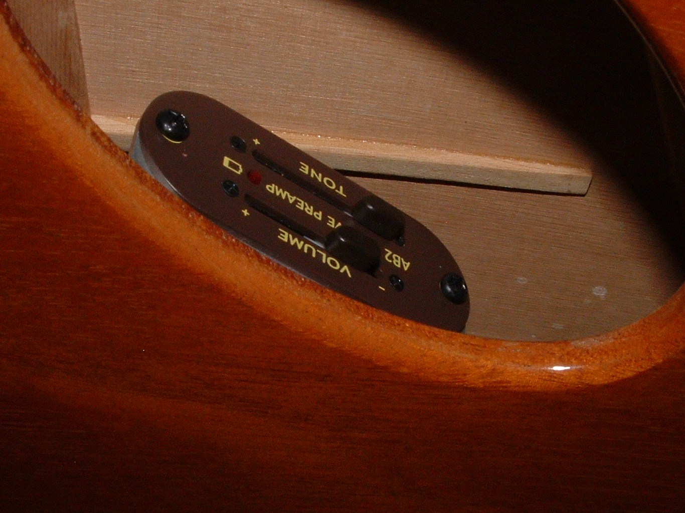

Hey Harry, I haven't been on here much lately, But the preamp I have is the soundhole mounted, because My Gibson Montana 2005 model Studio is hollow, and has a sound hole in the rear of the guitar.(click on picture ) And it was $90.00. I don't know what the end pin preamp's cost. If You call Rich He may even know a way to rewire the preamp You have now. Other than the thick saddle used by Gibson He build's each saddle to fit Your guitar's original size saddle. Years ago I changed the saddle in a Gibson Dove that had a tune-amatic metal bridge with a slot in the bridge as big as Your CE has and I made an insert to fill the void and cut an 1/8th" slot in the insert and mounted an under saddle pickup and it worked fine. So unless You can find some one with a broken CE guitar and working electronic's willing to sell You,You have that option. What ever Your choice is I'd like to know how it works out for You.
Skip
