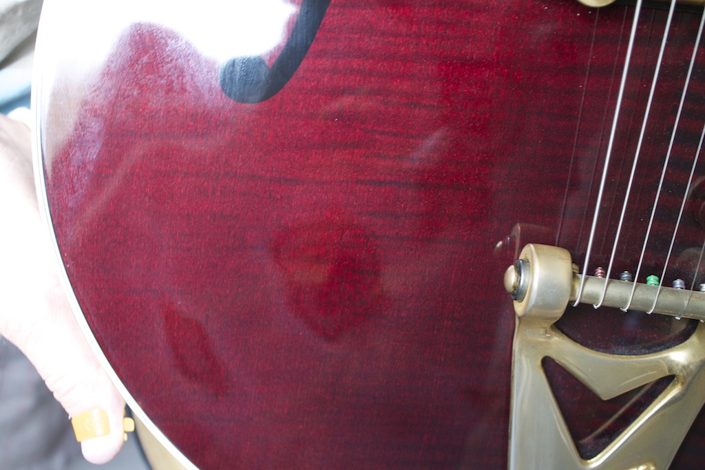

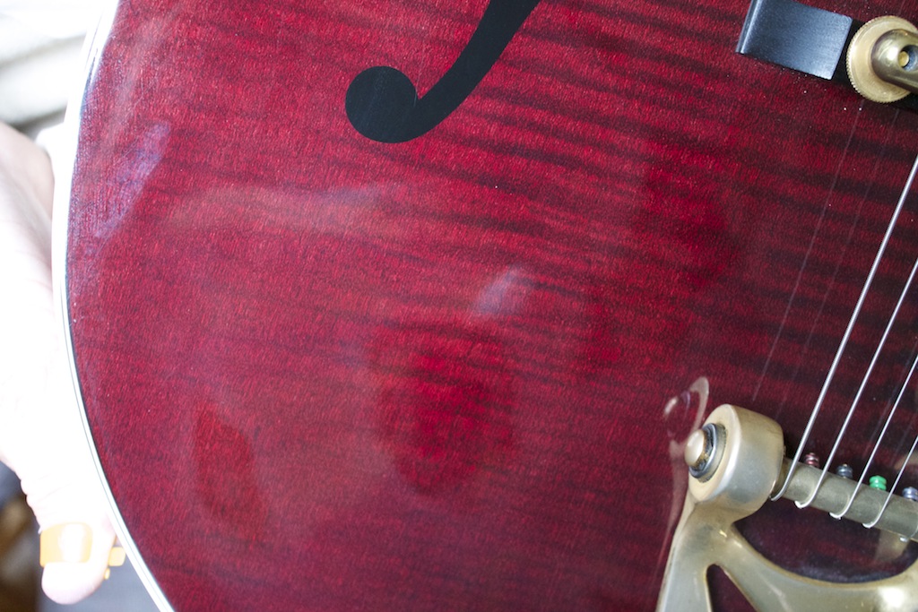

Anyone have a similar issue or help me understand what is going on with my guitar? Thanks

Looks to me like the the ol' proverbial "forearm sweat issue"!! It is common to all guitars and players. About the only way to prevent it is wear a long sleeve shirt when pickin' your guitar or lay your fuzzy yellow GRETSCH LOGO polishing cloth over that area to prevent skin-to-wood contact. But, now that it is already on there you might wanna try MEGUIARS PlastX clear plastic cleaner and polish. It is made specifically for polishing headlight plastic lenses but I've found it to be a great polish on guitar finishes and other delicate surfaces. Try it on a tiny inconspicuous area first. I think you will be surprised at how good it will shine and restore the finish. I use it on my guitars. But like Norm says, "your mileage may vary". It has been mentioned here on the ChetBoard before awhile back. Good stuff! Available at the big box store. Let me say something else. Meguiars makes in my opinion the best car care products out there. Their ol' #7 finish restorer is fantastic. So if you want your car or truck to last a long time and look it's very best, check into their line of polishes and waxes. And that "clay stuff" is amazing for really cleaning your paint before laying down a good protective coat of wax. Sorry for the long rant, but I like old cars too! Hope this helps! Steve

Thanks for responding. I don't think it is from my arm because it has similar finish issues on the back and areas on the top where my arm does not come in contact with. I just didn't photograph them all.

Could be a chemical reaction to something in your sweat. Some people have corrosive sweat. I knew one guy who could corrode a set of new strings in twenty minutes of play. He didn't sweat a lot but he was just a chemical disaster in some aspects.
They use some kind of polymer finish nowadays rather than laquer, I think. There has to be a common name for that kind of event but I don't know what it is. Knowing the proper term makes research a lot easier...

Well, that's mysterious. Is your humidity meter accurate? Does anyone else have access the instrument when unattended, or is it kept near any kind of HVAC port? Could some "helpful" person have decided to "clean" the instrument for you? Could it have been exposed to undesirable environmental conditions by a previous owner, and only now these are showing up? Have you checked the inside of the case to see if something in there could be the cause, when you do choose to put the instrument in it? This is wild, but could some fabric softener, etc., in your clothing be reacting with the finish? If it's not perspiration, then the cause must lie elsewhere. Keep asking questions.
The foam/rubber parts of some guitar stands can harm lacquer finishes. That could explain why the condition appears in various places on the instrument, but I'm guessing that the NC has a poly finish.
Wish I could help more. LMark

Maybe I'm slow... I don't understand what the problem is with the finish.
I do see some dried residue sitting on top of the finish towards the edge of the top, but the head-on view in the center doesn't seem to show up anything.
I ask because I once worked at the Gibson Nashville factory. I wasn't one of the buffers, but I can assure you every guitar leaves them with a flawlessly buffed clear coat. I was actually surprised how fast they can get a great surface when there is a fine line between removing all orange peel and burning through the lacquer.
Maybe a photo of the top picking up reflected light (looking at the surface at a 5-10 degree angle) instead of head-on will show what you're concerned about.
If the residue on top is the issue, it looks mostly like skin oil (and any polish if you've put it on the guitar; I never do). The fastest way I've found to clean sweat/nicotine/gunk off a finish is lighter fluid on a clean soft cotton cloth. Bunch up the cloth into a quarter- to half-dollar-sized round surface, squeeze on the naphtha/lighter fluid generously, scrub a small section of the surface with circular movement. You'll know instantly when you've cut through all the gunk to the finish surface, and you'll see the dirt buildup on the cloth. Keep moving to a different section of the cloth as dirt builds up and continue till the whole guitar is clean.

THe photo is not giving a good idea of the problem, I guess. T is hazy except for the small round areas. I have tried to polish it out etc. without success.
