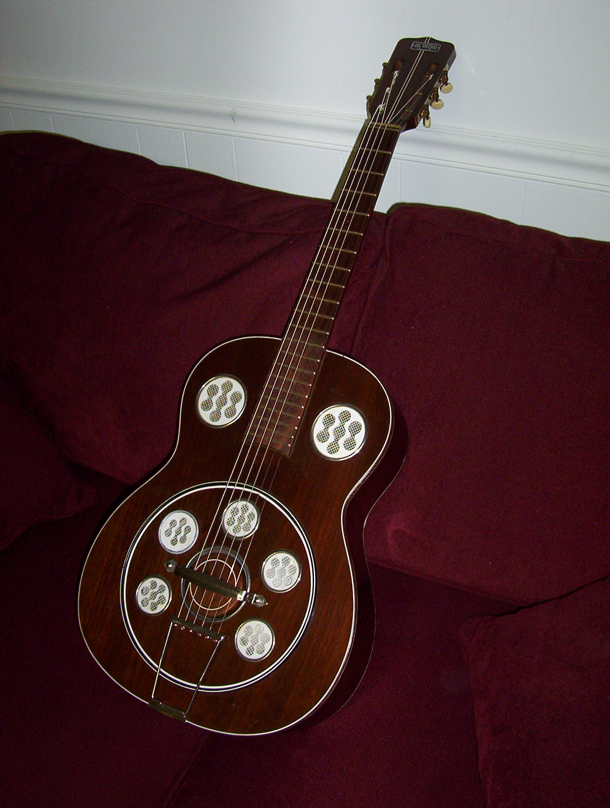

Just got my new Del Vecchio back from the repair shop today. It's a short scale and has that Chet sound. Man, I love this guitar. I put a mic up to it just so I could hear how it sounds. These are neat guitars...now I see why Chet loved them.

The Bottom of the fretboard that meets the body was slightly higher that the neck part, had the fretboard shaved down on the body part, a slight bow fixed, some frets leveled some, and a new saddle made for the biscuit. Not a bad repair job for only $100.
I had the guy put on a full set of silk and steel which I don't like. After talking with Craig I think I need to put a mish mosh of guages and and nylon ball end 5th and 6th
I'm probably gonna get a new tailpiece and cut it down and get some fine tuners so I can get just a little more tension on the saddle.....not too much just a little. But I'll do that later on after the convention. I wanted to hurry and get it back so I can take it to Nashville to play a couplf of tunes at the Hall of Fame with Eddie.

Gosh that thing looks like it's MINT!! How did you come across it? How did you know that date with certainty? Did you have to refret the whole thing? I had the same problem with mine. Where the neck met the body, there was a hump. Your lucky you only paid $100! Kirk charged me $600. But he did do a full refret. How does yours intonate? Mine is still really lousy. I am going to try my hand at making a compensated saddle. Hopefully that will help things a bit. They do sound phenomenal though, I just love them!

The store that sold it to me told me over the phone, the guy who consigned it said it was about '66 or '67. He must have been a Chet collector because the store owner said he brought in a bunch of guitars at the same time to be consigned and most of them were Gretschs. You can't see it in the picture but the finish isn't as glossy, it's got a very slight checking and when I got it the soundhole ring and white insert on the left side (where your hand/wrist cover it) was missing....I fabricated a new one for it. Apparently nobody sells parts for these things. I tried Paul McGill....no luck there.

I didn't have to get a refret, but later on I might get a whole new fingerboard with different frets....the ones on mine are good....everything intonates well. My repair guy is super cheap cause I've known him for a long time and he gives me a discount. Well, even though you had to pay Kirk $600...you got one of the best out there doing it and his work is top notch.
