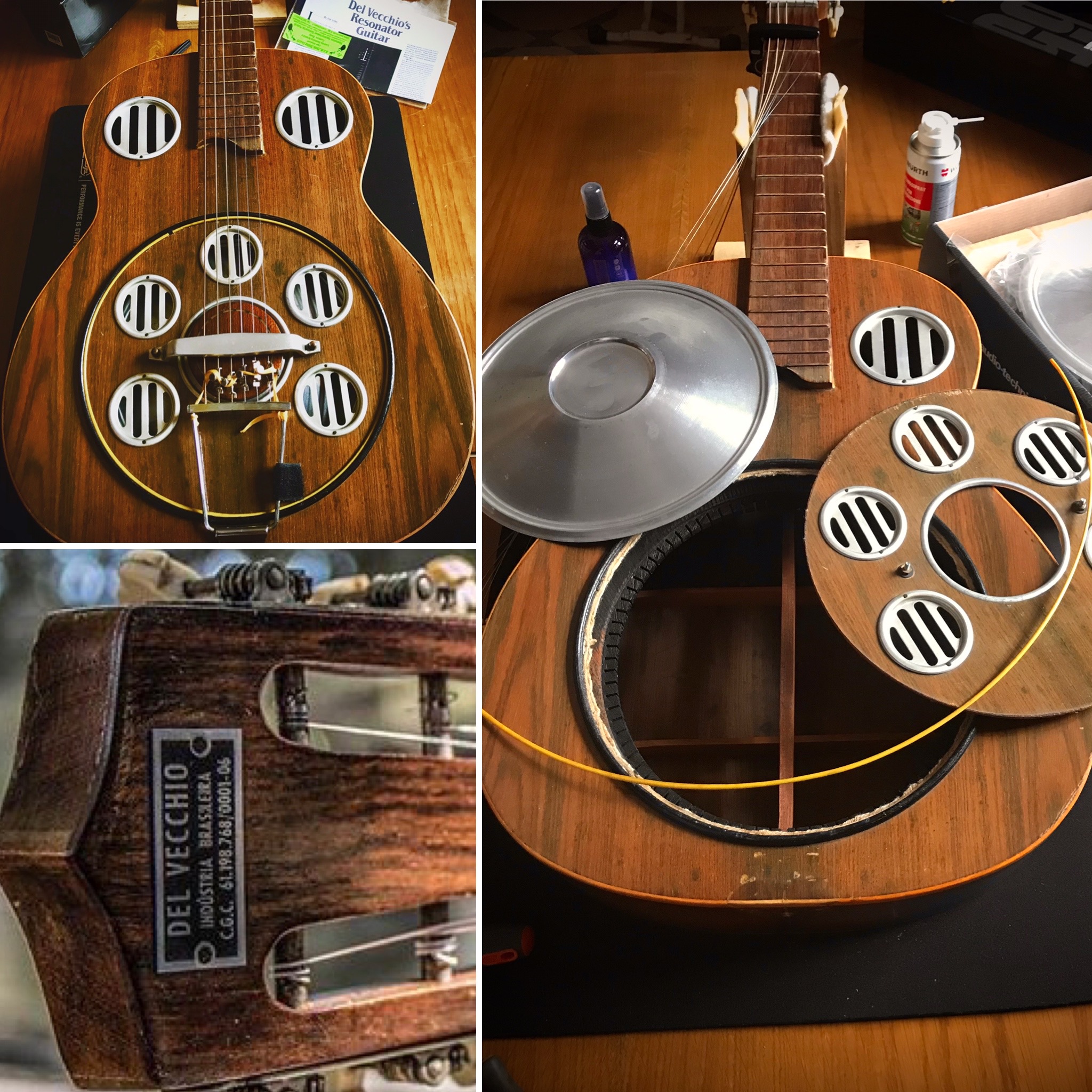

In these relaxing days, I'm on vacation, I have a lot of free time.
So I decided to do something I've wanted to try for a long time, change the aluminum cone in my DV.
The new cone purchased years ago, I believe it is from the "beard".
Well the result is fantastic, more volume but above all more sustaine;
I also believe that the tuning is more stable.
I would like to try the nylon bass strings like classical guitar, what do you think?

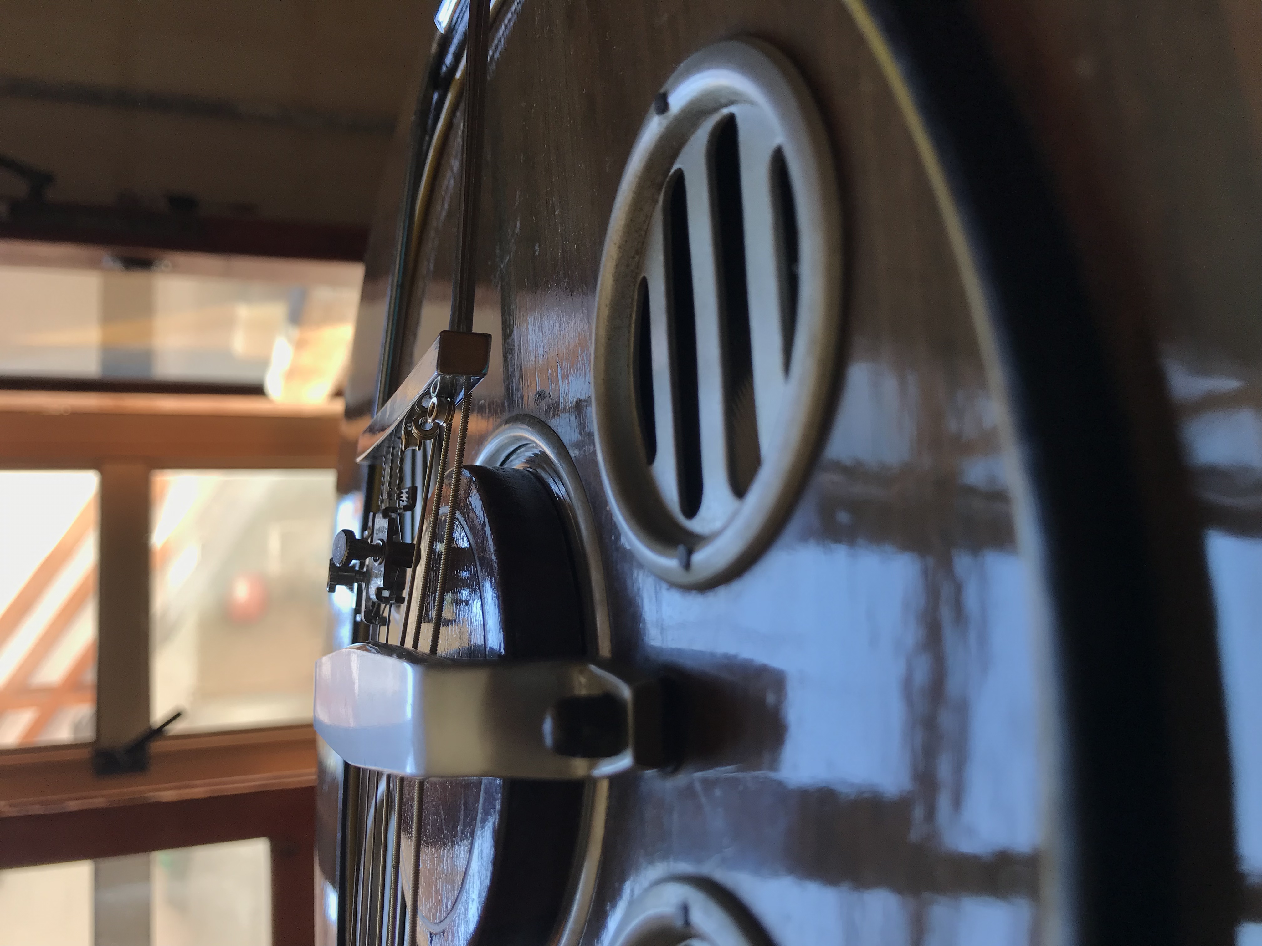

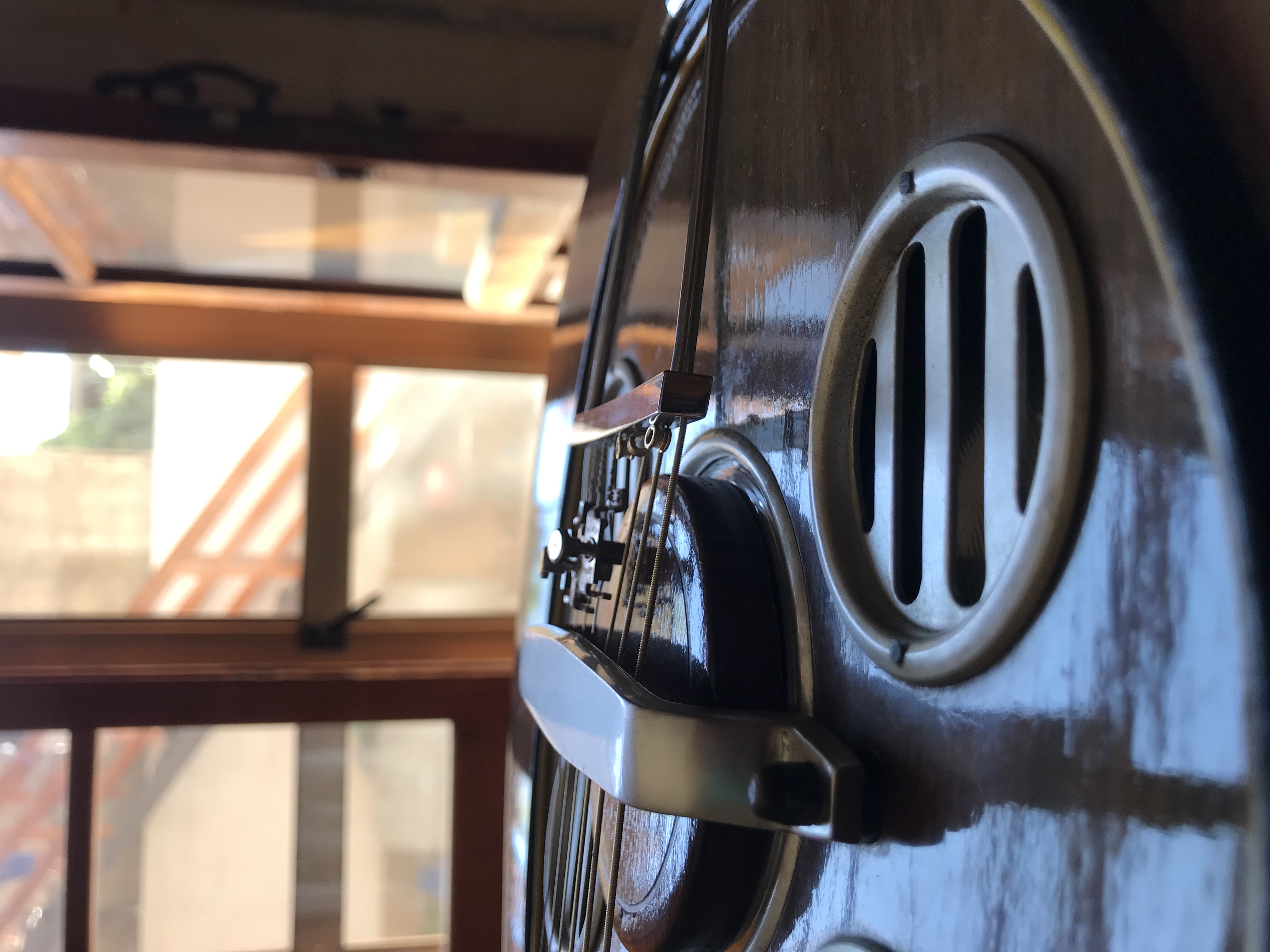

This morning I installed the three low strings of the D'addario EJ33 Folk,
practically nylon strings but with the final ball for the attachment to the suspension bridge.
I thought of assembling them in an unconventional way, but by making the string make a turn from the bottom,
so as to increase the pressure on the sleeve that weighs on the cone.
The result seems excellent to me, I hear even more the sound close to that of Chet's recordings.
The nylon strings give a "creaminess" a softness that contrasts with the twang of the high strings.
From today I will always mount the EJ33 ...
