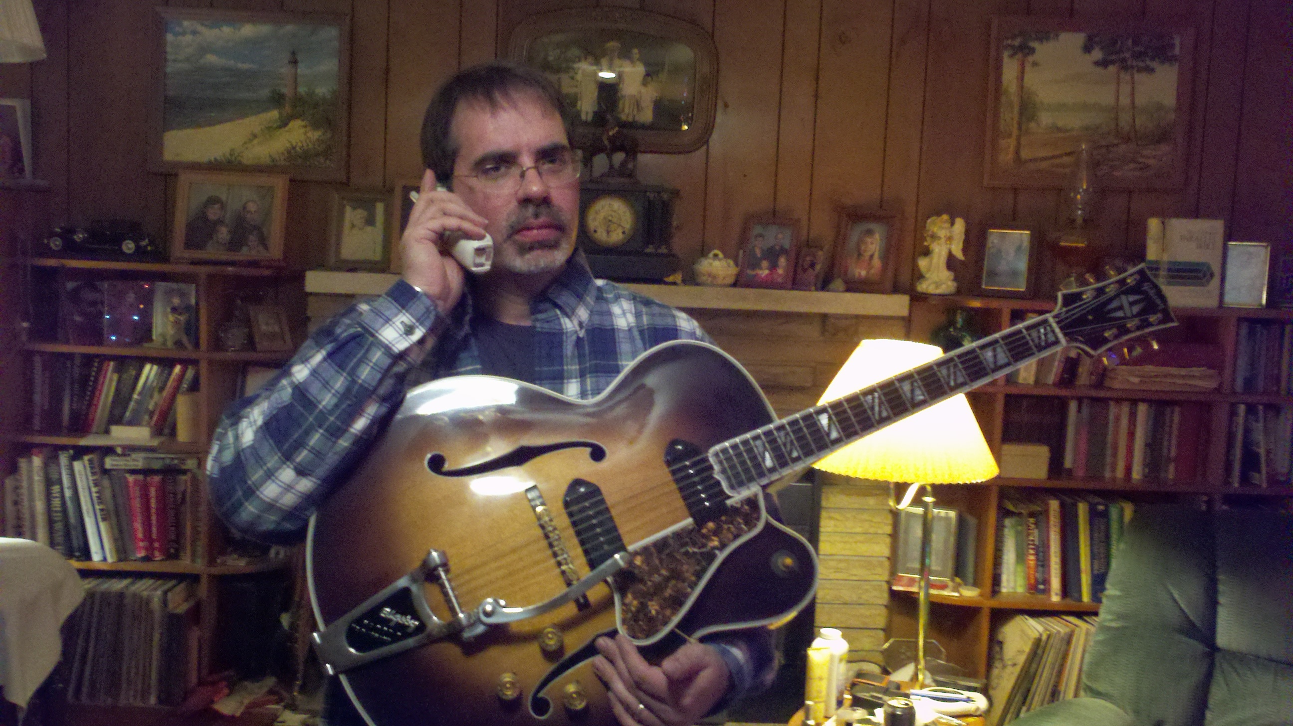

Postby Oddsteven » Tue Dec 28, 2010 8:20 pm
Your guitar probably has a laminated top. I don't recommend you do, but you can just about stand on the top of a guitar if it's laminated. Let me repeat that - don't step on your guitar!!!! :)
Brand new Bigsby on my Super 400 - Thanks Dad.

Postby Larry Lenhart » Wed Dec 29, 2010 7:43 pm
Wow, thats a cool pic of your super400. I am wanting to get a "merle" sound out of my Ibenez and so I ordered some P90 pickups called mean90.....not here yet, but from the reviews i have read, I know think I made a mistake in getting that brand...from GFS.....what would you recommend....I know I will never sound like Merle, but I thought a pickup change would help....my super400 has a floating pickup , which is great, but not that sound. Thanks for any advise.

My pickups are stock P90s, and despite my best efforts I really don't sound like Merle ;)
However, it does sound really good.
