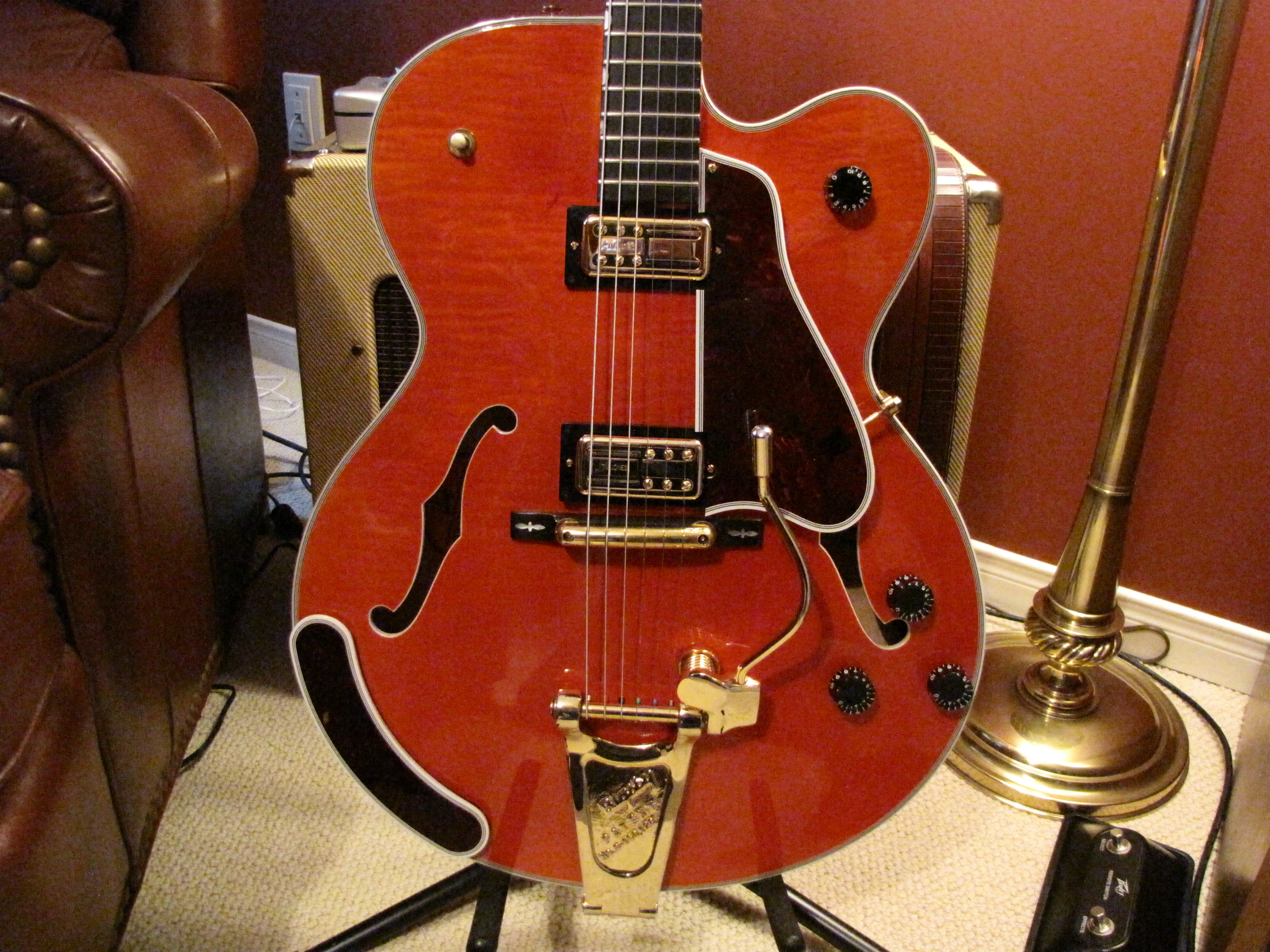

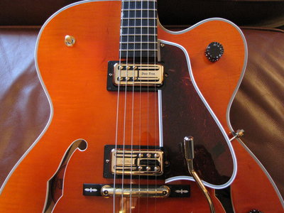

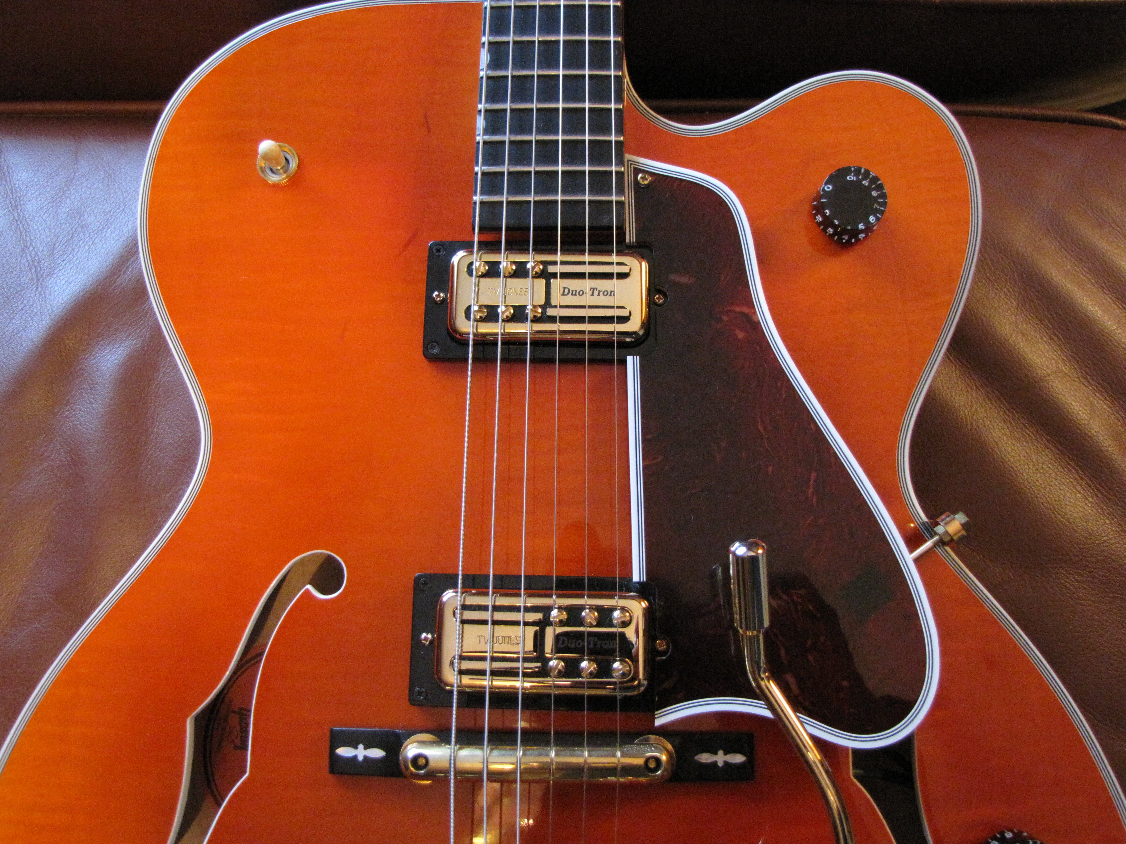

Hi Everyone: Just want to share my excitement with you in regards to the new Duo-Tron pick-ups installed in my Gibson Country Gentleman. WOW!! These pick-ups are great and really excel over the original humbuckers. The base side provide a rich full tone which truly complements the Chet sound, while the front strings are clear and responsive. These pick ups truly changed this guitar for the better. Thanks Bill

Chet said those bars made for "more note"
The pickup is nicely thought out. You can, to a degree, adjust the volume on your bass strings using the pole screws and the barred section keeps your main melody strings evenly picked up

The base side is excellent, however I would like the first E string to have a bit more volume plus fatter tone. Do you think raising the pole screws would achieve this. Thanks Bill

Raising the poles under a given string should increase the volume of that particular string. The blades don't have that luxury.
I see the guitar in the photo has the pickups opposing (facing differently) so on that one raising the pole on the first string on the treble pickup should give some gain there but of course that won't affect the bass (fingerboard) pickup.
Easy way to find out and you can always screw them back down if you want.
The other alternative is to take some shim material and put it underneath either or both pickups to raise the entire unit. As a rule, the closer the pickup is to the string(s) the louder the strings will be.
As long as you don't do any structural cutting or using non-soluable glue like epoxy you can always undo your experiment.

Really cool! Is there a Huge difference compared to the Gibson Humbuckers? I see you put on a bar bridge too, I bet that really changes things? Al

Thanks Norm...I will raise the pole first, if not much difference will raise treble side of pick up as I found there is some movement there.
Hi Al....Yes these pick ups are a major improvement over the humbuckers. The tone on all strings is brighter/fuller and very clean. Part of the improved sound definitely is due to the brass Tru Arc bridge. I had better intonation with the tune amatic , but the trade off is the better tone.
These pick ups will fit any guitar as the mounting options are standard (no ears ) or English mount.
